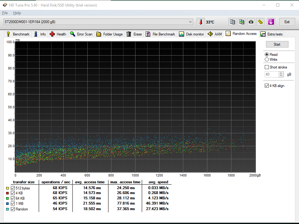

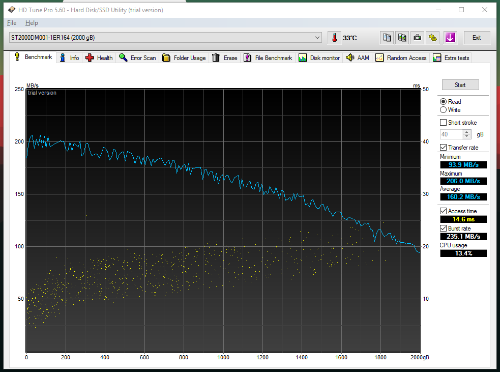

mh, smart values ok?
could you make a benchmark with hd tune and post the screen, and maybe do a full disc scan too (and post that too)

Used Seatools to run SMART test, Self test and Generic test, and all came back OK.
Here's the HD Tune standard benchmark:
What more tests should I run?

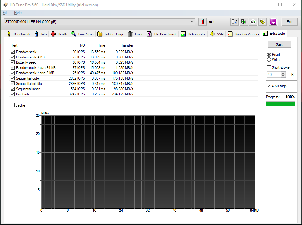

PostPosted: Wed, 20th Jan 2016 17:30    Post subject:
More tests:
Posts: 14964
PostPosted: Wed, 20th Jan 2016 17:37    Post subject:
As a comparison, I'd run your torrent on the Toshiba instead of the SSD.

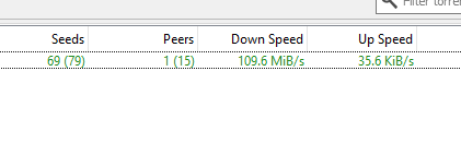

PostPosted: Wed, 20th Jan 2016 17:41    Post subject:
I was going to, but since those read/write speeds in HD Tune was better than in CrystalDisk, so I started another torrent just to test, and this was the peak:
Dropped to 70 mb/s for a short period, but now as I type this it's at 100+ again. Wtf is going on? It now completed 12.5 gb in 2 minutes, as it should.. It maintained an average download speed of 88 mb/s. Yesterday it was like 7-8 mb/s...
Posts: 14964
PostPosted: Wed, 20th Jan 2016 17:44    Post subject:
It could very well be related to the torrent at that particular time. Or maybe some other process was using your disk at the same time.
I've got a less than one year old WD Blue at 7200 rpm that performs worse than your Seagate. But its almost full aswell.
Janz
Posts: 14017
PostPosted: Wed, 20th Jan 2016 17:56    Post subject:
looks absolutely fine
