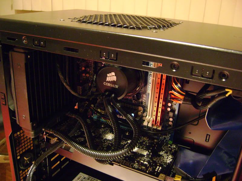

Posted: Thu, 24th Dec 2009 01:38 Post subject: |
I was sitting quietly next to the window all day long yesterday. The room was also completely silent it couldn't have been that I didn't hear the doorbell. Even when I went to the bathroom, I left the door open lol just incase but that guy just NEVER showed up. Right after 1pm I had a feeling he wouldn't come because the UPS usually always comes to my house between 11:30am to 1pm. I was a little pissed but then again Im on vacation so I dont have much goin on lol and so it finally came today, very early (earlier than any other UPS delivery Ive ever had before). The guy came at around 11:30am

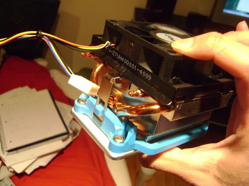

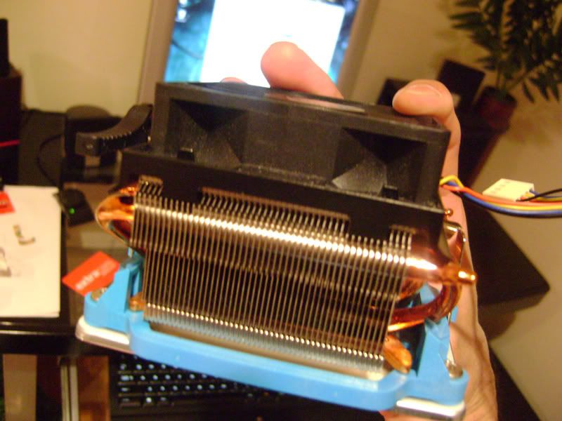

Anyways so installing this thing almost turned into a nightmare. Not because of the cooler itself. This is what happened...
The thermal compound that was pre-applied to the stock AMD cooler formed some sort of crazyglue-like material. I know thermal paste becomes hard when the heatsink is cool Im not a total moron... but this shit just would NOT come off. So I unlocked the heatsink but it wouldn't come off the CPU. The CPU was locked into the socket. So I figured the paste would eventually start to peel if I pull the heatsink with a bit more force. That pile of shit pulled the entire CPU out of the locked socket.....
Some of the end pins got bent. Not to mention it was still firmly glued onto the fucking stock cooler. So I took a heatgun and aimed it at only the heatsink and then eventually it just got hot enough for me to peel the CPU off that fucker. Next I was faced with the challenge of straightening out the damn CPU pins, not to mention the thing was burning hot when I peeled it off the heatsink with my fingers. So then I let it cool off for several minutes and then ran a credit card through the rows of pins to try and straighten that shit out. It was so fucked and bent that it wouldn't even go back in the socket
Anyways so I finally straightened out all the pins after running the card through the rows several times and then the thing was able to go back into the socket and then i was able to carry on with the Corsair H50 installation;
First of all the instructions that it comes with, are the absolute WORST. Basically it has like 6 unclear pictures and thats all. I guess they thought pictures would make it more simple but it actually made it more confusing. Apparently you must have a brain to install this thing lol.
Heres an example of what the instructions show...picture shows that you install the bracket and then you put the head of the cooler onto the bracket and twist it to lock it.This was definitely not how you do it. I had to loosen the bracket screws, insert the cooler head and twist it into place and THEN tighten the bracket screws to lock that thing onto my CPU.
It does require you to take your entire mobo out to install the backplate. I left the pre-applied thermal compound on the copper plate.... I trust Corsair! Anyways so after installing it all, this thing looks nice. Had to take a few pics lol
This is the AMD stock cooler than came with my CPU:
With the stock AMD cooler, I was able to overclock to 3.7ghz with okay temperatures but the fan rpm would be ridiculously high. Since the fan would reach around max rpm with 3.7ghz, anything past 3.7 and the temperatures would begin to rise real fast. At 3.8ghz i would get like 62-65C. My room temperature thermostat is always set to 72F (22.2C) degrees.
So anyways with the new H50 cooler, I was able to clock to 4.0ghz. I can't get 4.1ghz to stay stable in everest. So I ran everest for a few minutes to check out the temps and these are the temperatures now with the H50:
Right now the CPU is chillin at 32C
