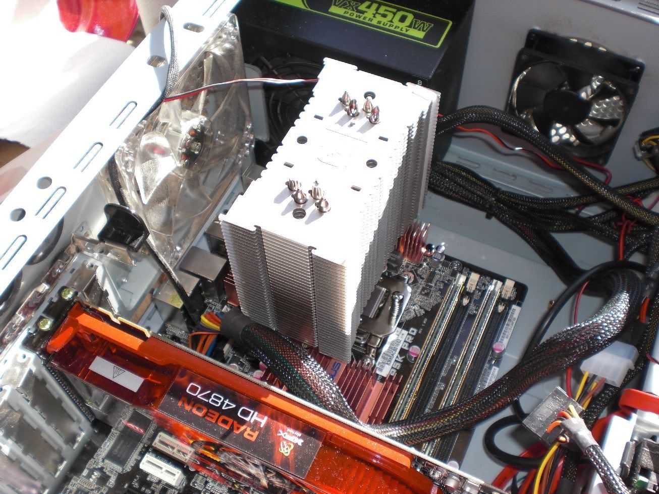

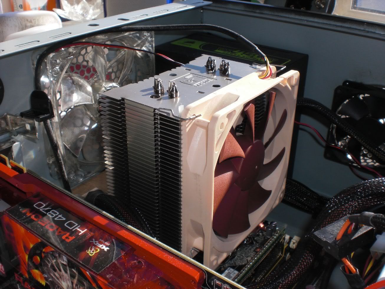

I finally got around to fitting my Noctua NH-U12p cooler and everything went great. I used the included, and often rated better than AS-5, NT-H1 thermal paste and seated the cooler exactly as specified with zero issues. The problem is, my machine is now idling at a full 14c HOTTER than it was with the STOCK cooler.
On my stock cooler, pushing my E7200 at 3.4Ghz, I got 40-44c idle and 55-65c load. Now, with this new cooler - which is supposedly one of the best you can buy according to numerous reviews\benchmarks - the idle temperature is 51-56c and it loads at 70c.
I've got it running a single 120mm in a pull configuration, pulling cool air from the inside the case (fed by a front 120mm and a side 120mm intake) and pulling it over the heatsink and out towards the rear 120mm exhaust. So what's wrong with it? Does it REALLY need a burn-in period for the thermal paste to start working properly .. or is something fucked?

wtf that burn-in crap, if it shows current temps the way they are they will stay that way, in time more dust absorbtion will make it even hotter, so yeah something is fooked
either u applied too much thermal grease or fan speed is too low, there is also a possbility that radiator doesn't sit very tide, take your pick
considerably how crappy stock cooler really is noctua should perform much better

yeah check the heatsink mounting, can't be much other than that.
oh and try reversing the fan. for example, i've got an old thermaltake sonic tower with the fan "sandwitched" in between. the side of the heatsink where the fan pulls air through it is quite a bit hotter than the one he blows through, just tested it. so if your temps go down with the fan pushing air over the heatsink (even though you've just fucked up your airflow Very Happy ), you at least know where the problem lies. Wink

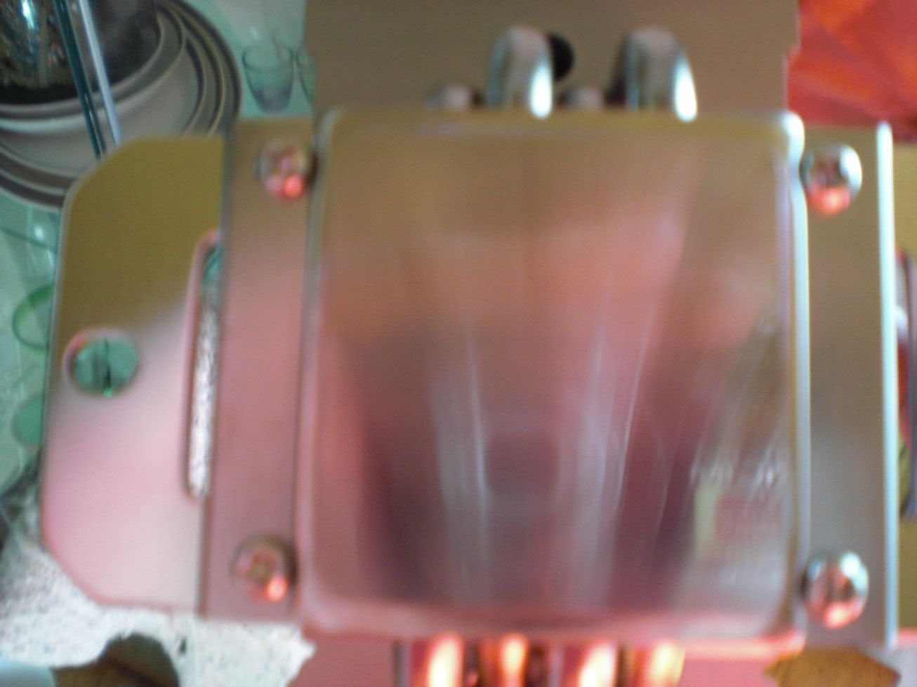

Removed cooler, wiped paste clean, reapplied (again, just a dot as per instructions) and reseated the cooler. I even switched my 90mm top exhaust to an intake just to aid airflow. Same idle temp, but now it doesn't go over 60c load.
STILL not acceptable, not considering how "awesome111" this cooler is supposed to be.

Best bet is to use a different TIM. My Q6600 idles at 30C even at 3.4Ghz so something is definitely wrong with your setup there.
Did you check to see if the base of the heatsink was machined well? And when you removed it the first time was it making good contact?

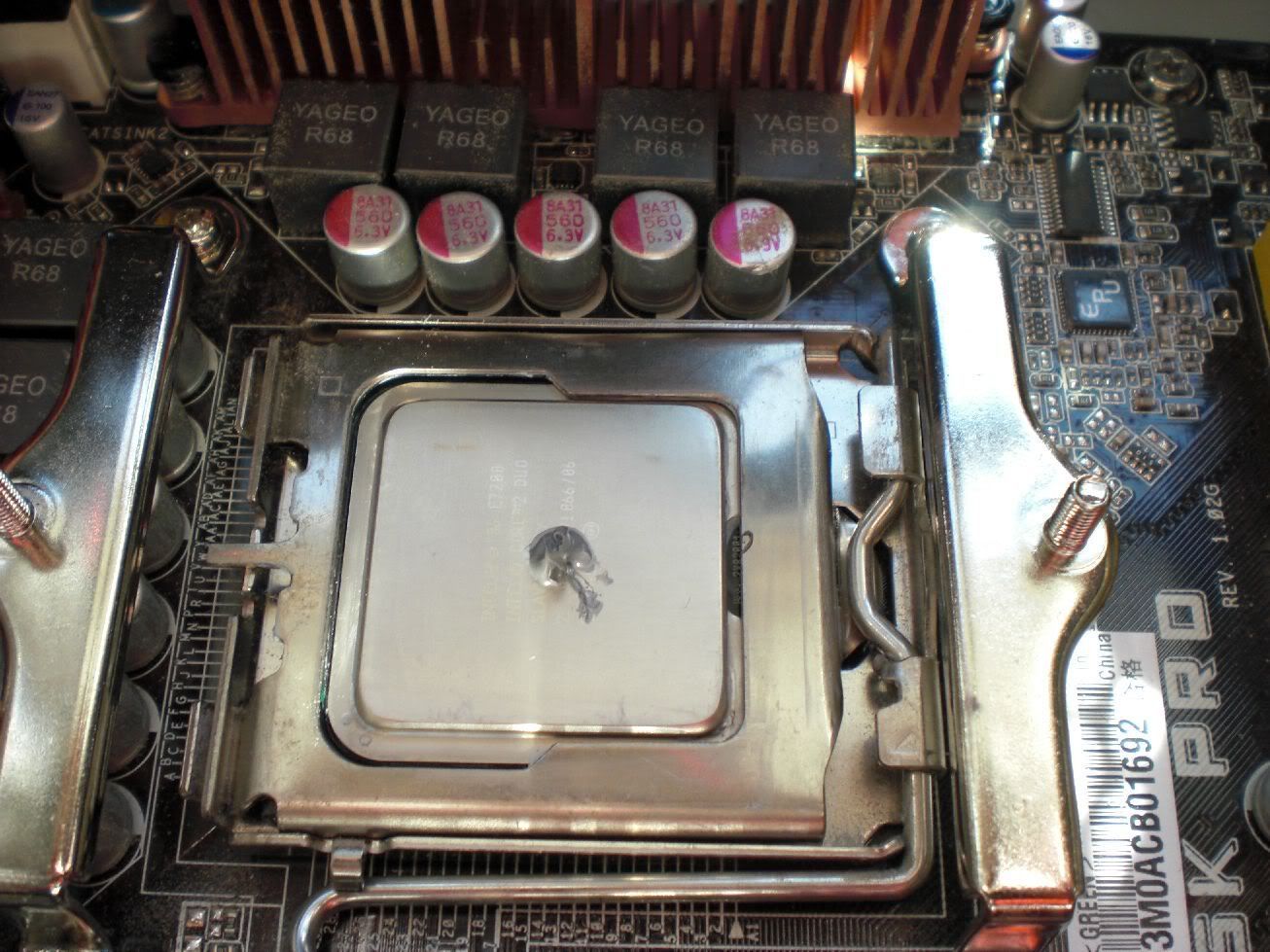

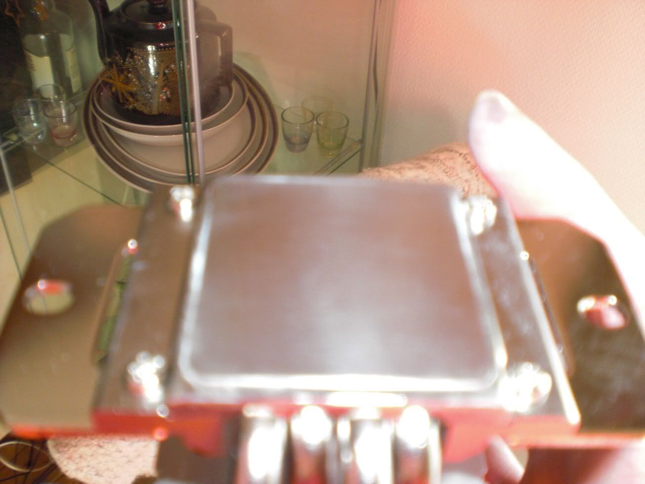

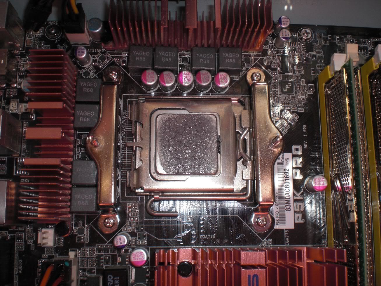

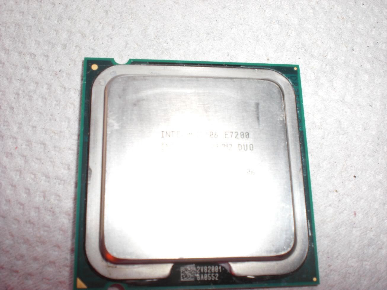

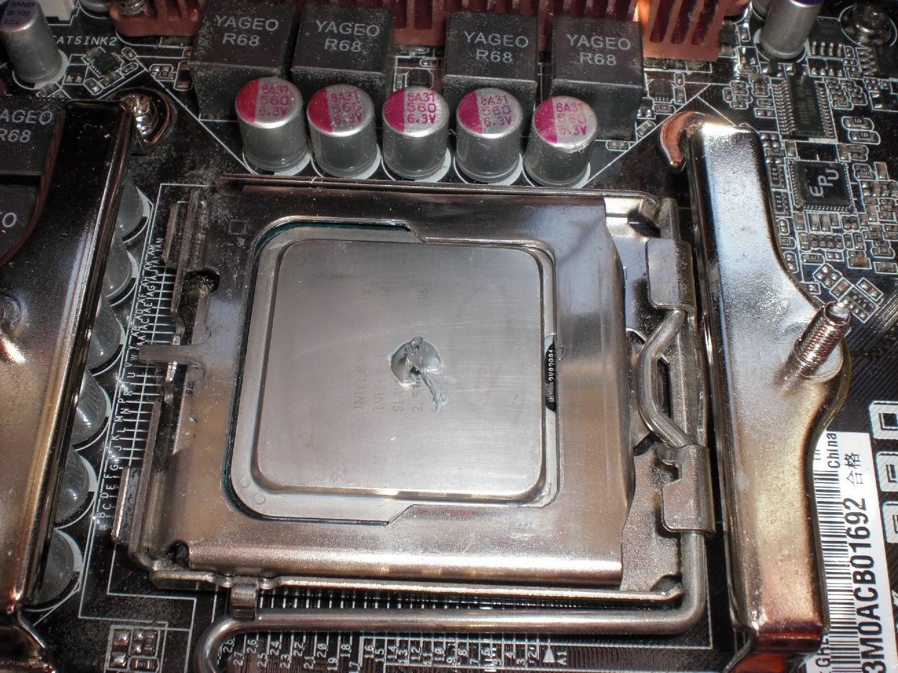

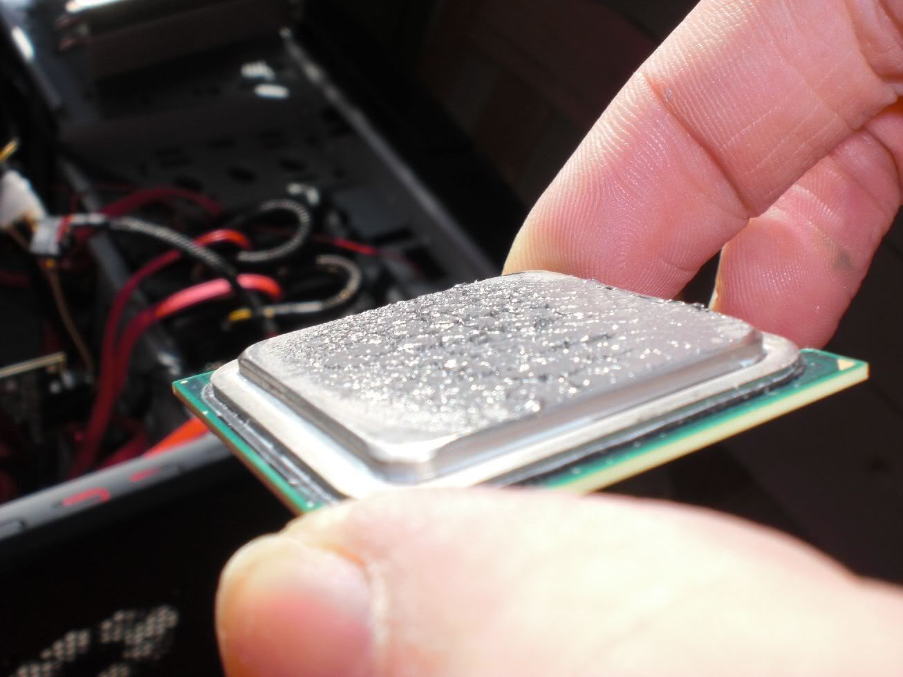

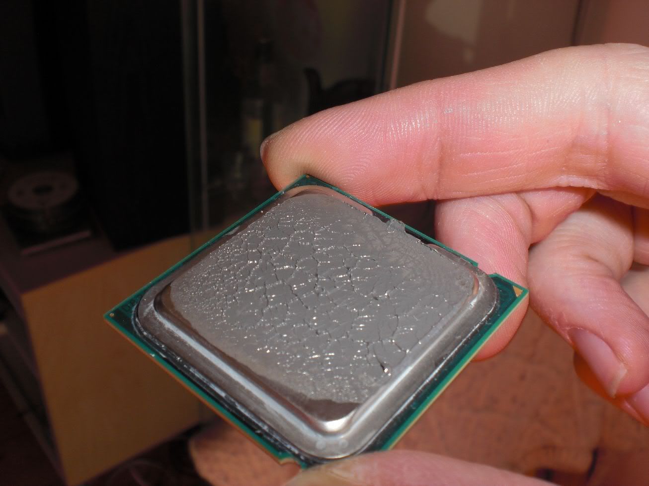

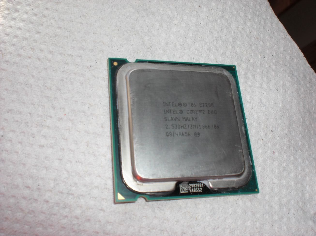

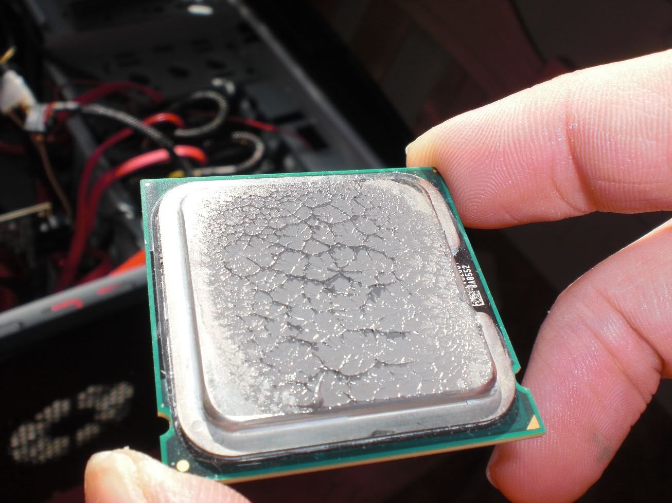

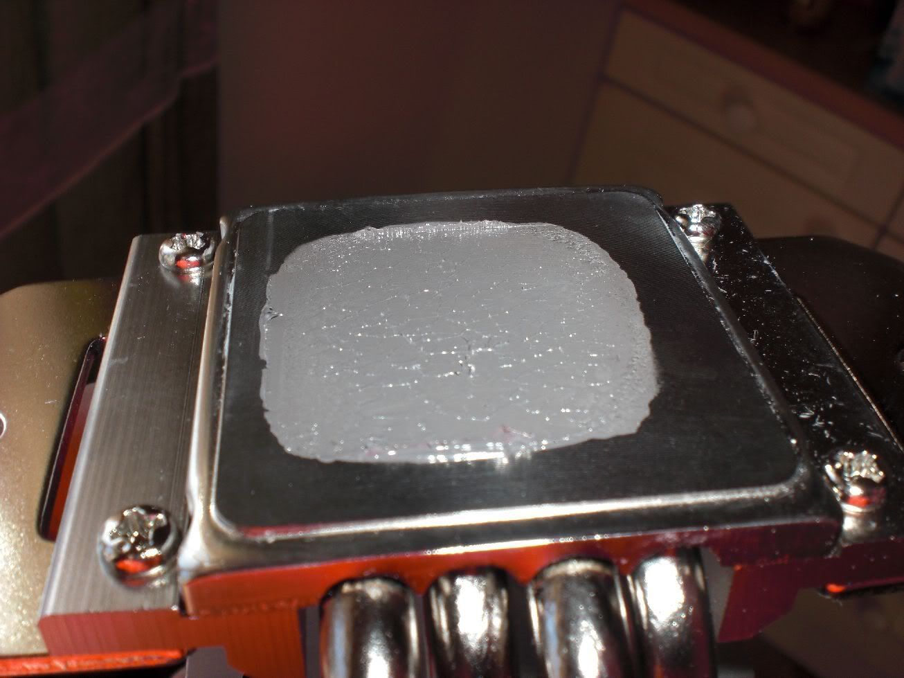

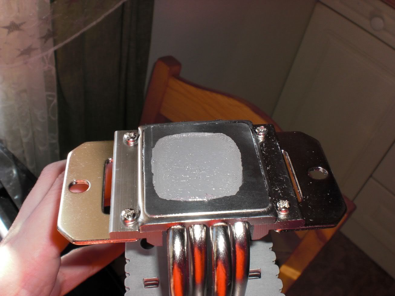

Here's my post from my regular forum;
First few shots are from last night's application, following are from my subsequent cleaning of the HSF and CPU heatspreader (I used white spirits and soft tissue until they were gleaming) I then, again, followed the instructions to the letter and put more thermal paste on. Reseated the heatsink, twisted it back and forth as much as the mounting bracket would allow (barely 2 degrees either side) and screwed it down tight.
The contact with the CPU is absolute. The clamps are as tight as possible. The heat paste is done to the best of my ability and the directions given. Still the heatsink is absolutely ice-cold ... it's just not drawing heat from the heatspreader on the CPU.
Cheap, Taiwanese-made, bullshit.

PostPosted: Fri, 20th Mar 2009 11:05    Post subject:
Even though the heatsink is still ice-cold, idle temps are now 36-39c (depending on whether or not I have the window open in the flat) and full load (Orthos and, hehe, playing UT99 at the same time) 55-56c.
I are confuzzled. How can the temps be lower when the heatsink isn't drawing them away from the chip itself?

if you want to know if your new heatsink is making proper contact with your cpu remove the fan & within few seconds your entire heatsink should be hot if its not then your heatsink base needs to be lapped to make a full contact with your cpu. good luck.
