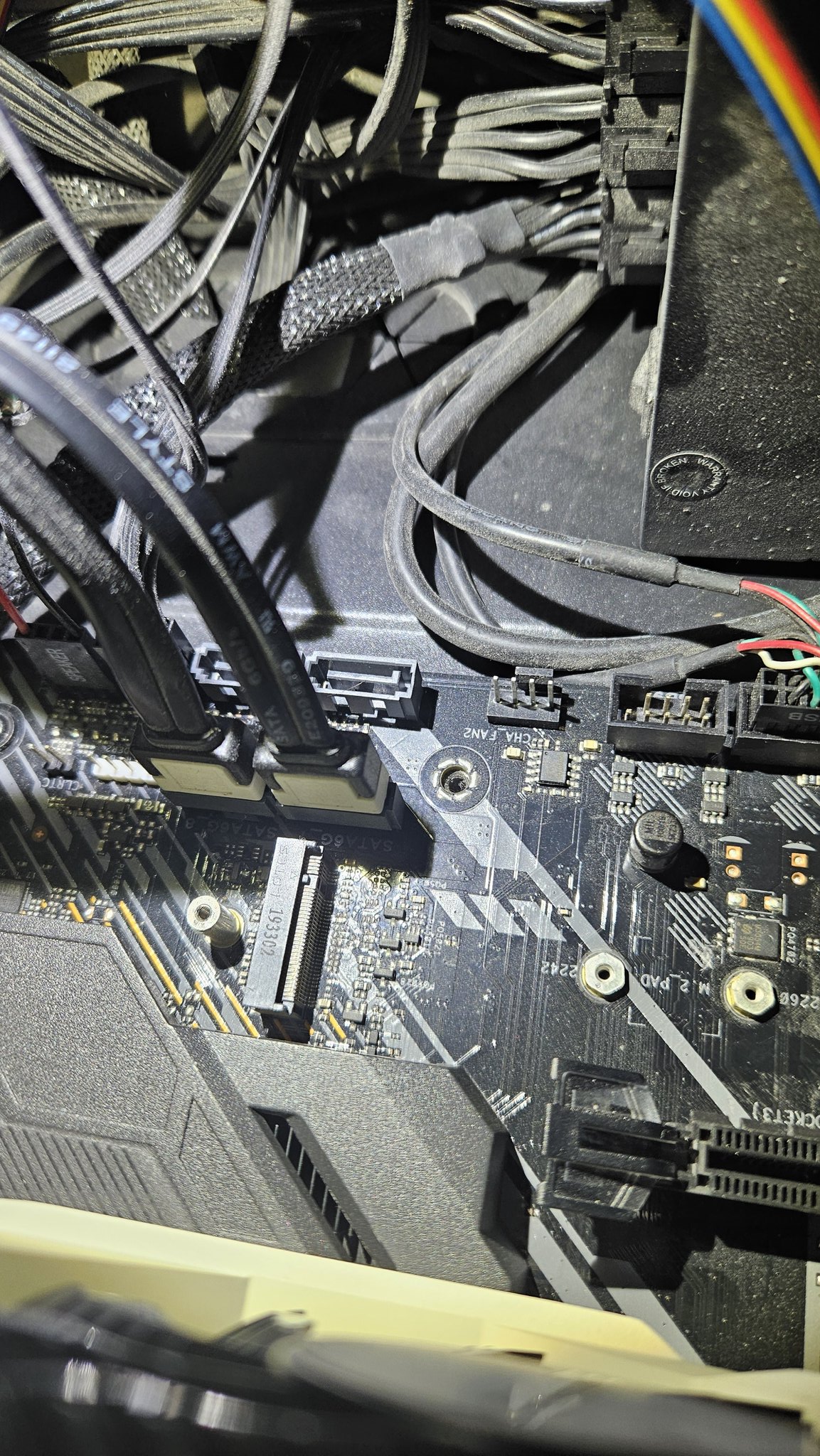

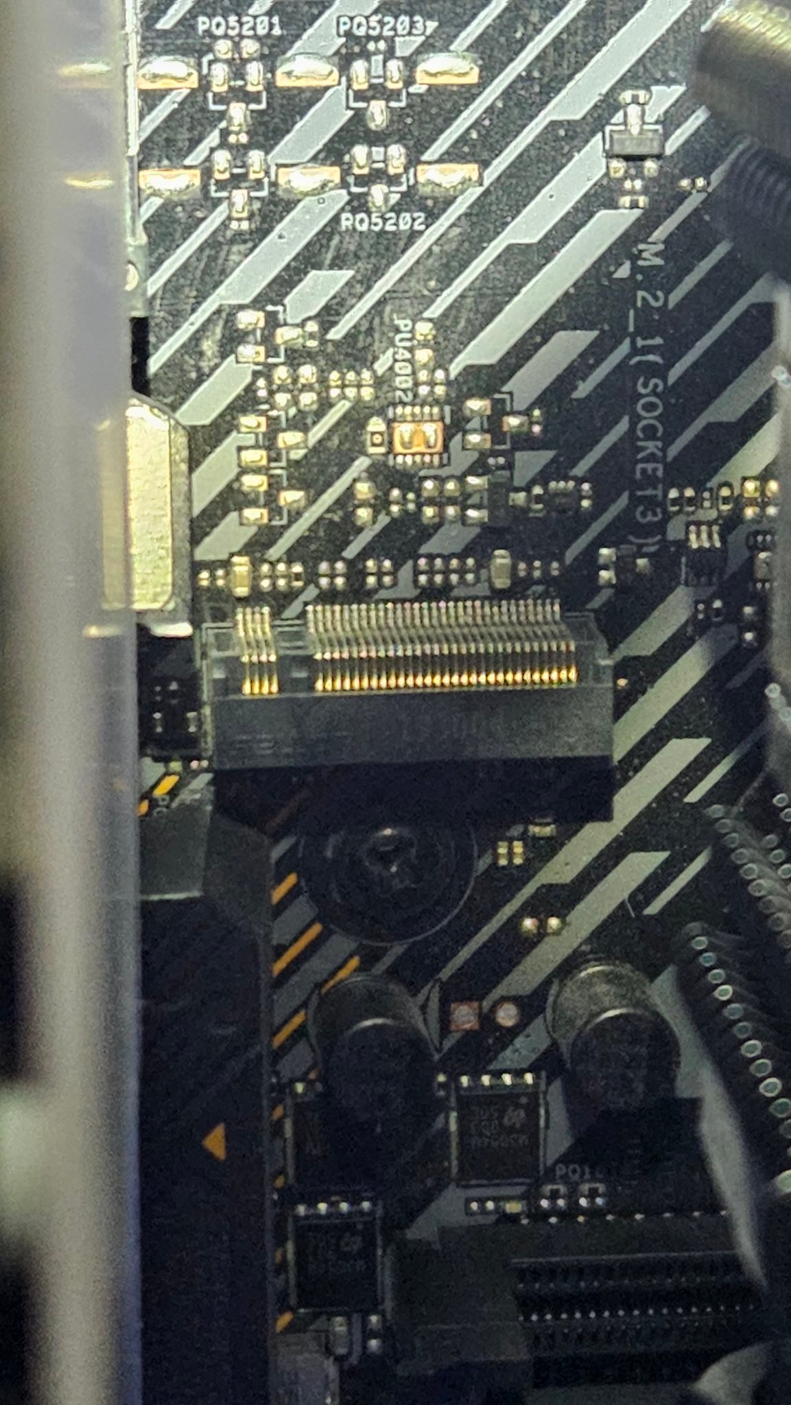

I'm asking again: Do you think i've broken the M.2 port , burned it or something?. I mean, after that freeze the M.2 still booted up just fine but i'm not sure about the port itself.
EDIT: Unplugged the PSU for a min, unscrewed the heatsink and poked around the M.2 slot. It's still in it's place, won't budge nor wobble at all.
I've also made a couple of photos with a flashlight (Else it's too dark) for ya guys to check the pins
https://pbs.twimg.com/media/Frk7NfnWYAM79kK?format=jpg&name=large
https://pbs.twimg.com/media/Frk7NyoXgAAWG5N?format=jpg&name=large
The one below is the M.2 between the GPU and CPU , to compare the pins, but now that i notice, the 1st 2 pics have a few pins that seems to have been cutted in half
https://pbs.twimg.com/media/Frk9PHbWYAAI1ma?format=jpg&name=large
Still, if what @DXWarlock said is true, the socket's pins could be fine and unburned afterall (Although he didn't mentioned anything about a burning/heat smell, like when playing an AAA game on Ultra all and the CPU gets hot and has that noticeable smell)

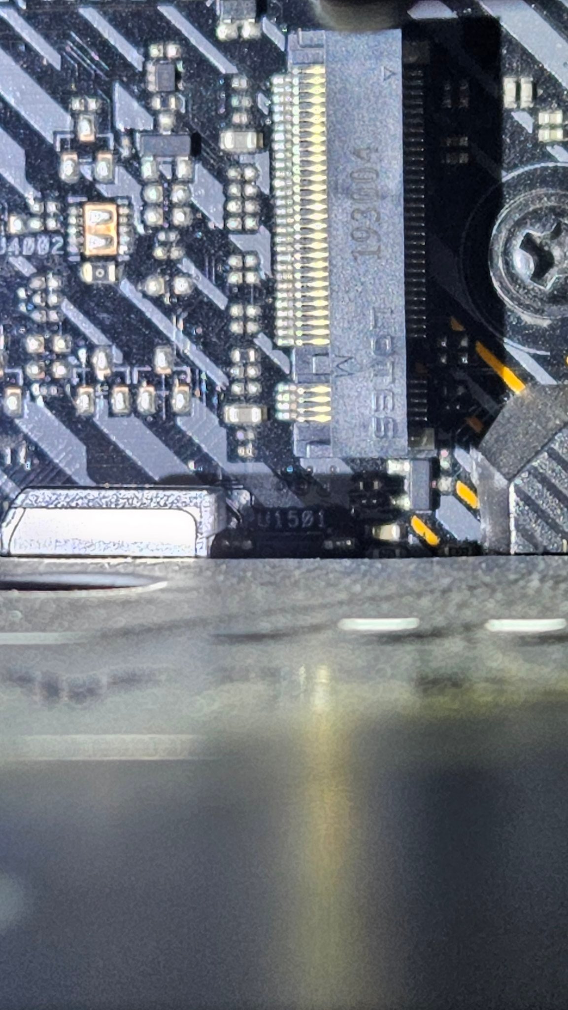

I've made more photos
Note:Top of the port's numbers references are:
193004 = GPU CPU slot
193302 = Heatsink/Between PSU and GPU slot) :
193004: (Pins mainly)
https://pbs.twimg.com/media/FrlC9dwWIAAGWhs?format=jpg&name=large
https://pbs.twimg.com/media/FrlC9M0WwAEnc4J?format=jpg&name=large

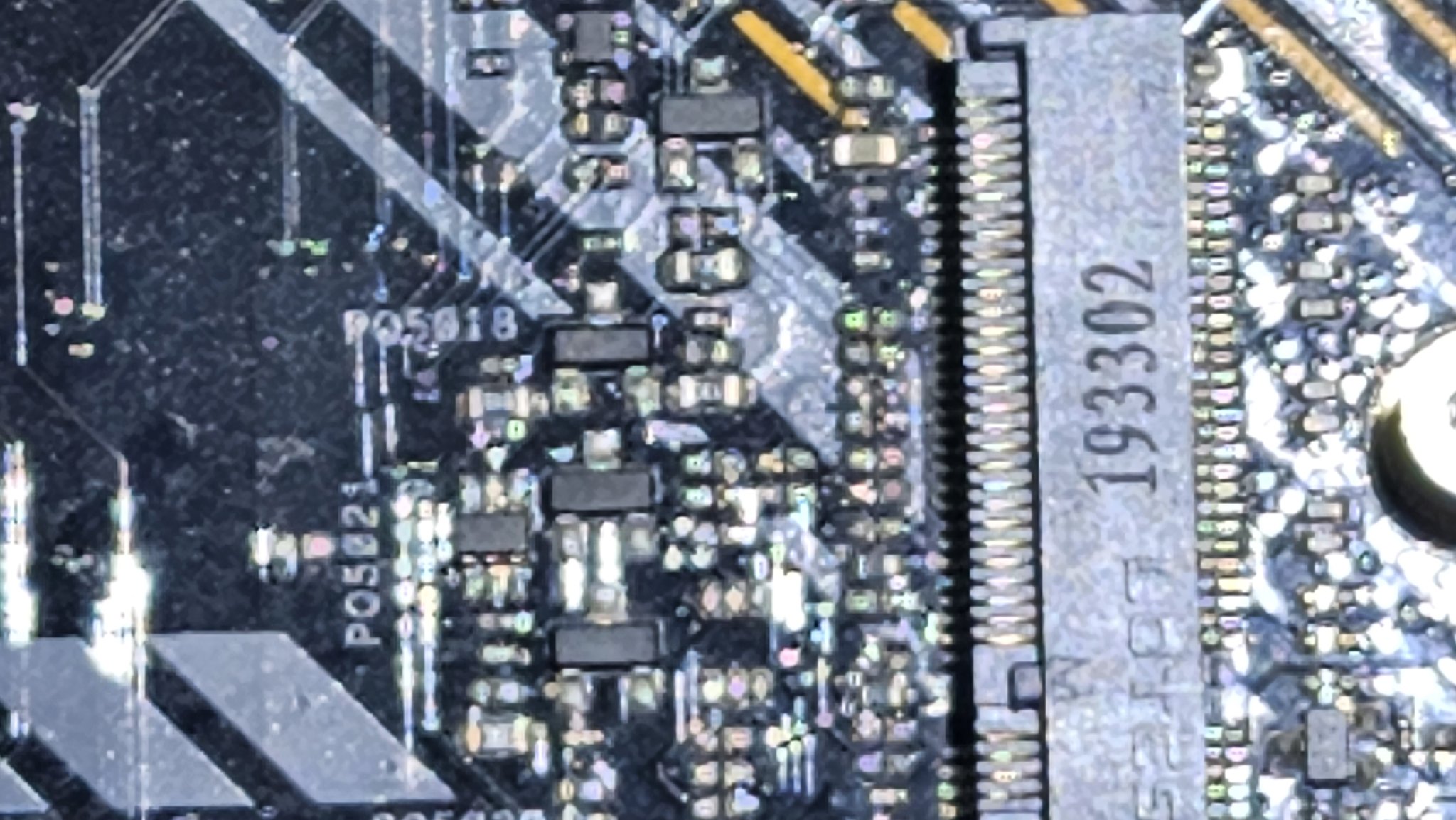

193302:
Whole area (Forgot to put the M2 pad back in place. The screw area i used was the 2280 one ) https://pbs.twimg.com/media/FrlDCbOWcAQY7GE?format=jpg&name=large
Pins: https://pbs.twimg.com/media/FrlDC2AXoAEwZ8V?format=jpg&name=large
Another pins one: https://pbs.twimg.com/media/FrlDEPUWIAAxtOZ?format=jpg&name=large
Looking at the newer n better zoomed photos and the use of my powerful flashlight, the pins on the 193302 seems fine and equeal compared to the first photos of the 193004 above, without looking like there has been some shredding / making the pins thinner from the previous post
Hopefully this helps

DV2
Posts: 5253
PostPosted: Sun, 19th Mar 2023 12:49    Post subject:
AmpegV4 wrote:
pins look okay, really only comes down to the SSD shorted something where it made contact with the board. What exactly made contact? if it were only the memory IC's on the SSD and no metal on metal, maybe you are ok?
Can also see wear in the corner of the M2_Pad part of the board, maybe try de-dust, micro-cloth clean that part and look for wear. The white paint is inconsequential but what about those 2 solder points the 2 closet legs of PQ4872..
Can also see wear in the corner of the M2_Pad part of the board, maybe try de-dust, micro-cloth clean that part and look for wear.[/quote]
As i said, without knowing about the "nuts"/leveling screws, i screwed the SSD into the 2280 hole directly and instead of being straight it was aimed slightly down towards the screw.
Probably that PQ4872 and the SSD weren't touching due to the diagonal height space
I just simply don't know how it could've survived some hours, even while playing DOOM ETERNAL at 43C all the time (Used Crystaldiskmark while playing the game and was doing ALT+TABs (Borderless full screen) and refreshing it to check the temps)
Are you saying that maybe the M2 SSD (NOT THE PORT) got screwed but the M2 port is probably ok?
EDIT: That's a rubber mark from the M2 Pad , photo below. I used my nail (Again, PSU unplugged) to poke it and it was definitely the sticky part of the M2 Pad). Also shown the PQ chip
https://pbs.twimg.com/media/FrlK0VoWcAA6cBY?format=jpg&name=large
Freiwald: I removed it because i thought it was getting in the way , while the M2 port near the CPU did NOT have the rubber pad. But as ya said, it was to touch the sticky part below the heatsink to cool it off
In that case i'll try to calm down, but for now i won't buy another NVME for a long time and if i gotta get one i'll buy one with a heatsink already with it (Maybe WD SN850X with a firmware update) and place it next to the CPU to make sure i don't stress the , possibly?, bottom port out

Well, the screw was holding the SSD in place and the screw didn't wobbled, so the SSD was just touching probably the screw's base/hole area, not the motherboard. You could try checking out on yours (if ya have one) to see what i mean. (Think of pushing the M2 SSD all the way down to the screw's hole without the screw that makes the SSD go straightly placed. There's ya answer with my issue)
Like this https://prnt.sc/9kH1xPe5yt4K
Removing the M2 SSD had the same similar sound like when ya pull off a RAM stick from it's slot, that cringey sound, only less noisy and easier to pull off.
That might be the case, the detect a disk. I mean, i moved the SATA SSD and HDD to the right side of the tower (behind the panel) placed vertically with it's drive holder hanging and the cables were a bit of a pain to plug, but they were firmly placed and detected on W10. But still, as DXWarlock said, "bad connection" (in my case, diagonal sag)
The fucked motherboard case cannot be the possible, because once the PSU plug out (when freezed) and the burning/heat smell happened, i was able to boot onto the 980 PRO without any issues (No BSOD nor anything)
For now i'll hold off onto M2s and resist with the 2 SATA SSD (1TB OS, 500GB files) and 1 4TB HDD. Don't wanna go through this hell again. Actual mobos and CPUs are way more costful (X670, RYZEN 7000 series... RAM Training bullshit, and my X570 board isn't listed in shops among us anymore, only the WiFi version)
"Resist" because i wanted to upgrade one SATA SSD , the backup one, from 500GB to 1TB, but actual SAMSUNG and Crucial drives, 870 EVO and MX500 respectively, have been giving reports on DYING drives with the latest batches, while my SATA SSDs, an EVO 860 (OS) and EVO 850 (Files) are working fine for years
Hence the looking out for an M2 as the OS, use my 1TB SATA for files ...You know the drill
