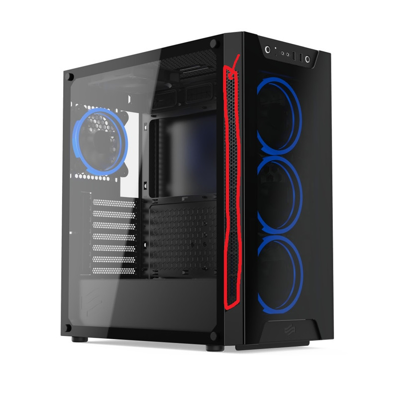

Hi guys so my old case, zalman z1 neo, was getting really hot on top. And I figured I should buy a case with a mesh top, cuz I'm a genius. So after I bought SilentiumPC Armis AR6X TG, I noticed that although it has a mesh top, it doesnt have a mesh front. So i've bassicaly traded my front mesh for a top mesh. I'm confused now whether I wasted my money or not, and if I should cancel my order or not.

Thanks for the reply guys, the new one also has a outtake fan on top to go with the mesh. So that's good. Only worried a bit that my intake fans on the front are less powerfull due to the glass.
Anyway its too late to cancel the order, just checked, the case is on its way, I really hope the front intake will sufice.

If the front ones are restricted by the glass, some case makers go for looks over function but not all. Get some high static pressure fans for the front. It will help 'force' the air through.
Some people try to put high volume fans thinking 'they blow more air, so more will make it' not always. Most super high volume ones are not good at static pressure and need free flow air to work well. Otherwise they are just like a desk fan you put a sheet on the back of: Blade spins like crazy, but its just doing so while moving very little air.

Anyway, I think worst case scenario I will crack the small vertical mesh on the front and make a bigger hole Very Happy Need to see how hot it gets first.
